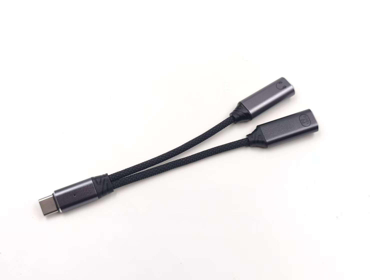

And buying thing like this one, to feed extra power, with longer cable
Another thing is the quality of type-c cables for both sides
Got to be good
