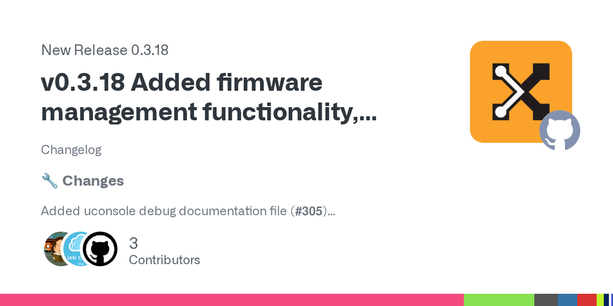

Originally posted by Kevin Peng on Discord, 7 July 2025.
Release v0.3.18 Added firmware management functionality, improved d…
Changelog
:wrench: Changes
Added uconsole debug documentation file (#305)
Fixed typos in README.md (#302)
Updated udev rules and corrected the lrelease path in documentation files (#299)
Implemented firmw…
This release can restore and backup firmware, and you can get the 1080p firmware from the link, https://assets.openterface.com/openterface/firmware/Openterface_HID_Firmware_240815.bin
