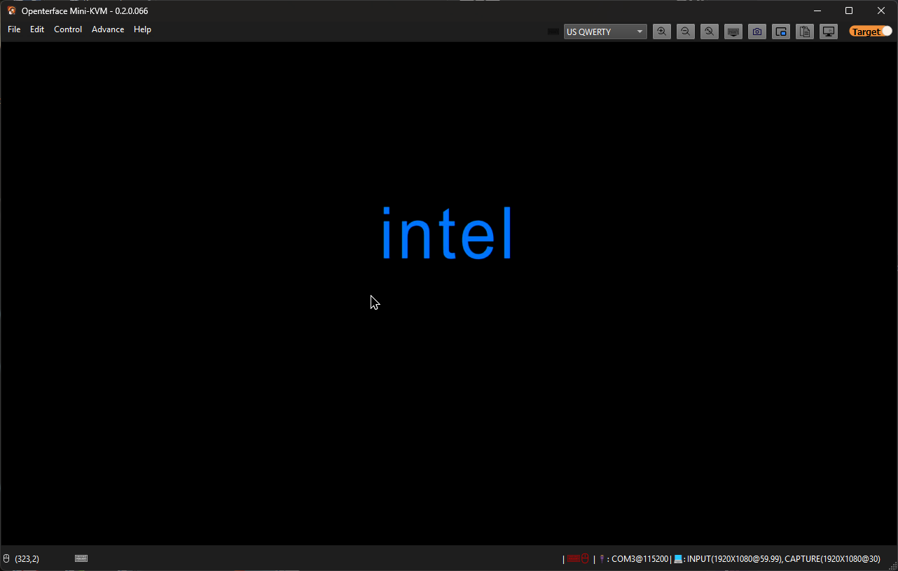

The QT app on windows is not consistently connecting to the keyboard and mouse, and i do not know why. I would like to debug this further but do not know how to get the QT project files set up on my system to change the source code around..

Are you using the official toolkit cables or your own? Try using a USB 2.0 port on the host computer, I think there is a issue with USB C to USB C connections
Originally posted by bradcarnage on Discord, 23 March 2025.
yeah. OEM cables included in kit. tried also using aftermarket ones etc. also tried using HID reset firmware upgrade etc
it connects alright (host to device), but for some reason the HID function will just stop working?
Originally posted by Kashall on Discord, 23 March 2025.
I have issues with this too. I think it is something with Windows itself as leaving the app open the serial device will disconnect
sometimes it’s fixed after a reboot, sometimes not
i will try rebooting, then connect host side, then target side
this fixes it
OH
i think when the program segfaults, or crashes, it won’t release the COM port
Yeah okay there’s something weird going on there then
when closing the program normally it seems to release the COM port properly. i think a “try except” block is needed then to release the com port even if the program crashes or something goes terribly wrong
