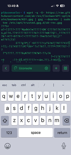

You can add my repo to your existing install by
wget -q -O- https://raw.githubusercontent.com/ak-rex/ClockworkPi-apt/main/bookworm/KEY.gpg | gpg --dearmor | sudo tee /etc/apt/trusted.gpg.d/ak-rex.gpg
sudo add-apt-repository -y "deb [arch=arm64] https://raw.githubusercontent.com/ak-rex/ClockworkPi-apt/main/bookworm stable main"
then do sudo apt update && sudo apt install openterfaceqt
Originally posted by AK-Rex on Discord, 25 August 2025.
it’ll add a menu shortcut in system tools

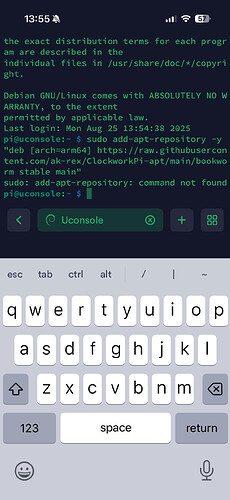

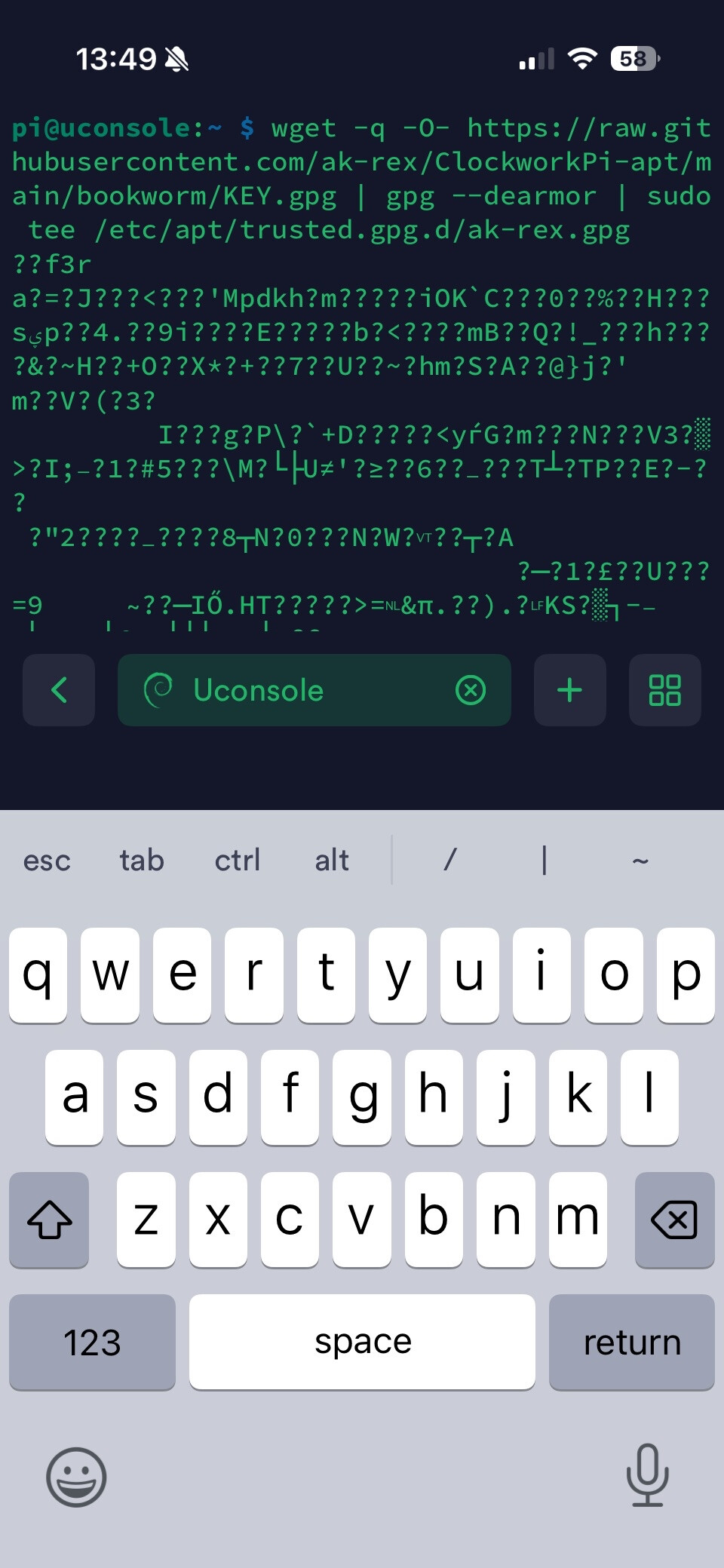

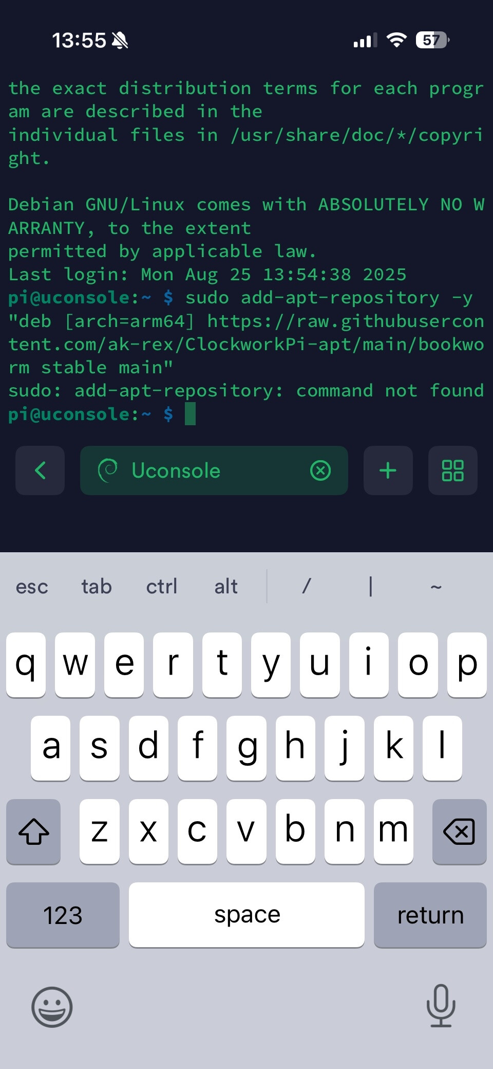

Originally posted by cellfreak on Discord, 25 August 2025.
Commands do not work
that looks like it worked now do the second command

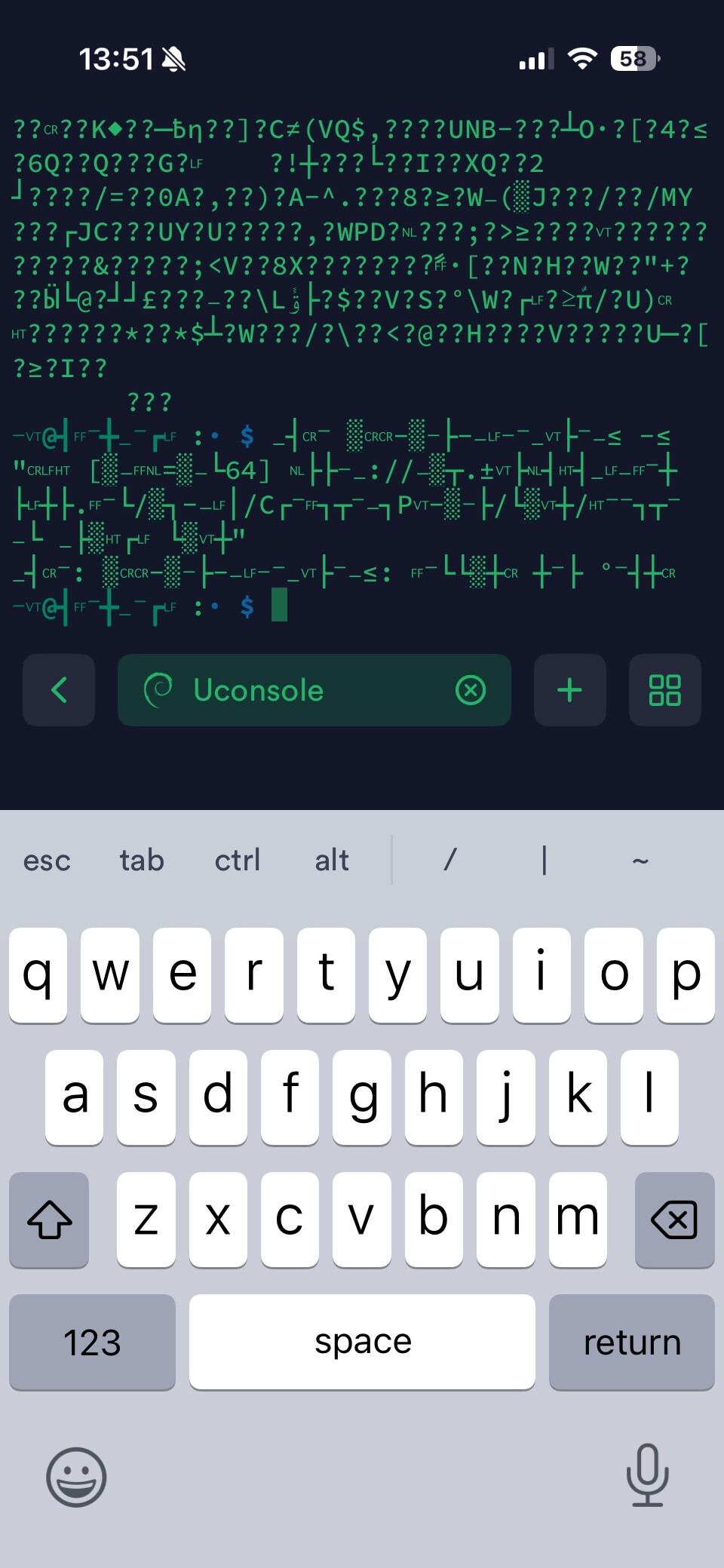

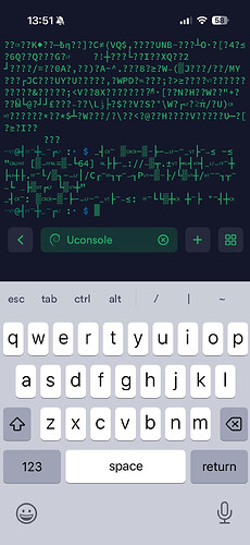

Command not found
