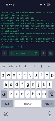

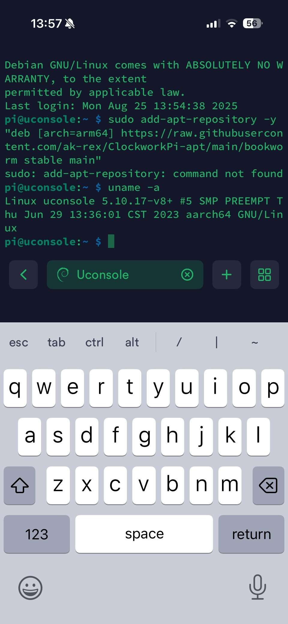

it’s uname -a with a space after uname
do sudo apt install software-properties-common then add the repo again
Originally posted by AK-Rex on Discord, 25 August 2025.
I know you don’t want to do a new OS but you are using a 4+ year old kernel that doesn’t get any updates even security ones.

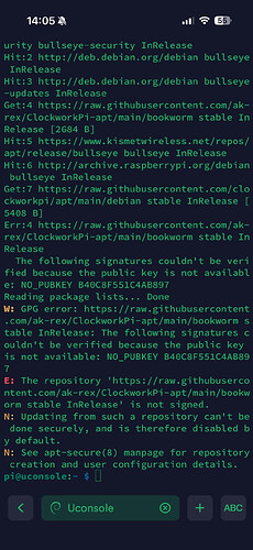

Originally posted by cellfreak on Discord, 25 August 2025.

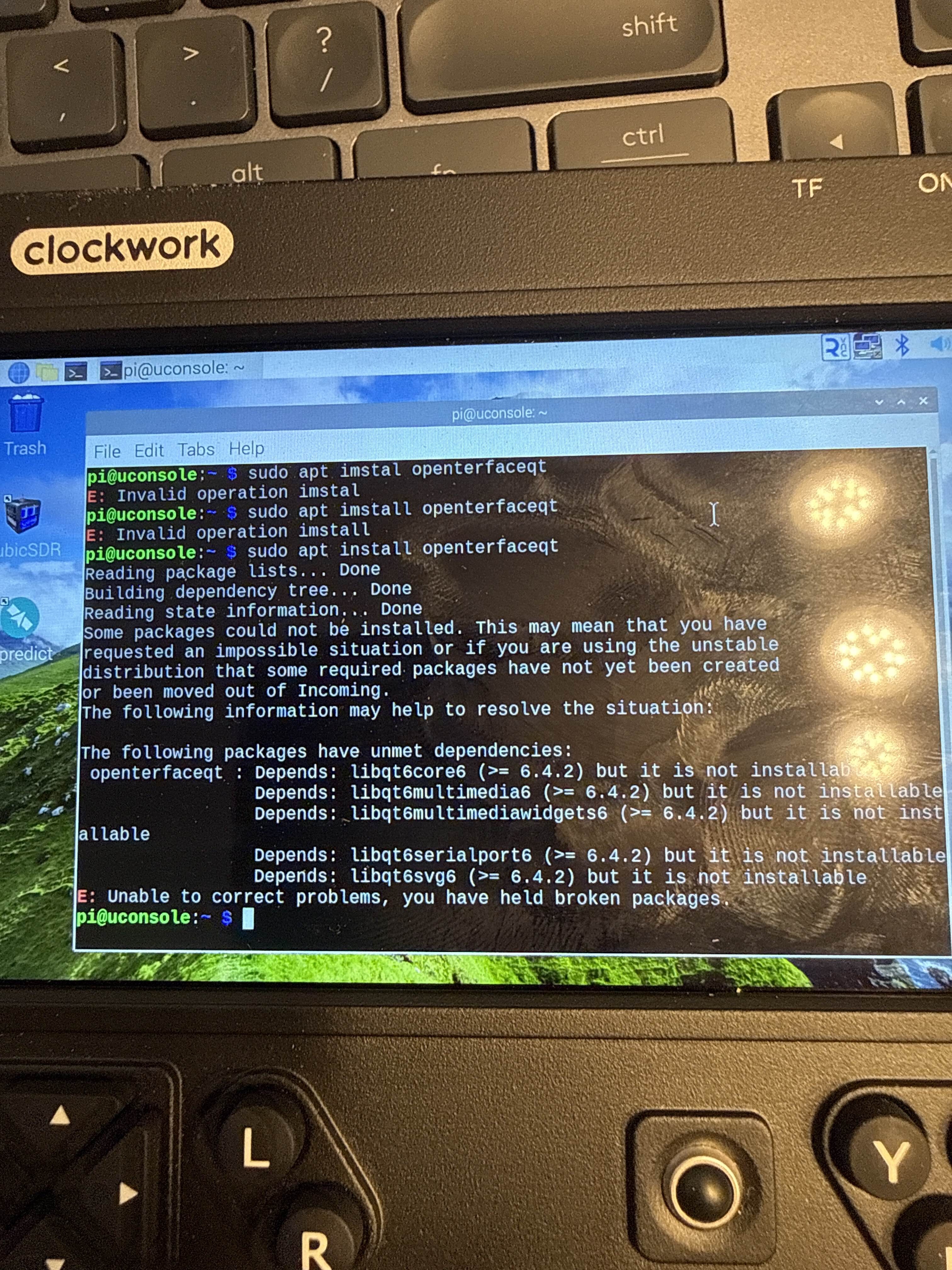

Got errors will not install

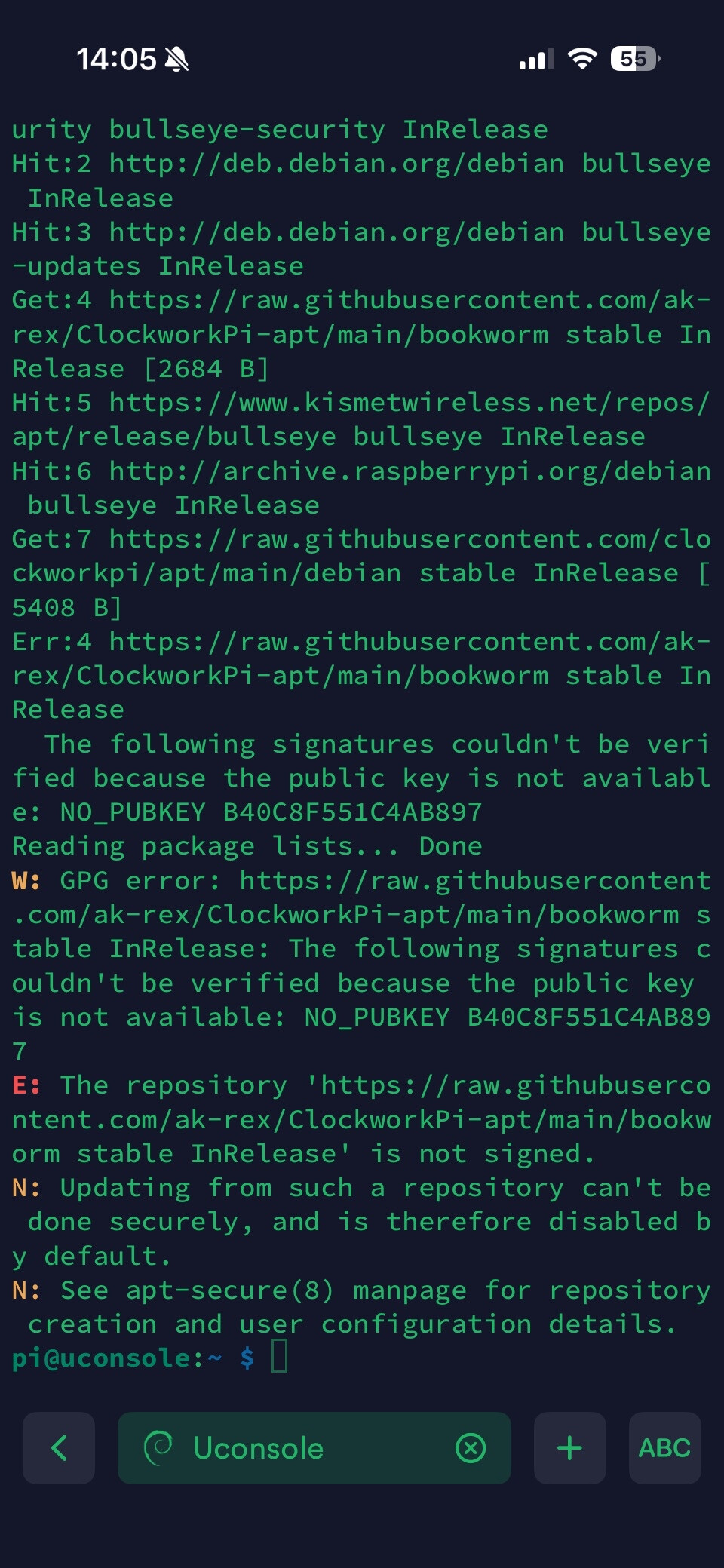

try this again
wget -q -O- https://raw.githubusercontent.com/ak-rex/ClockworkPi-apt/main/bookworm/KEY.gpg | gpg --dearmor | sudo tee /etc/apt/trusted.gpg.d/ak-rex.gpg
Will not install

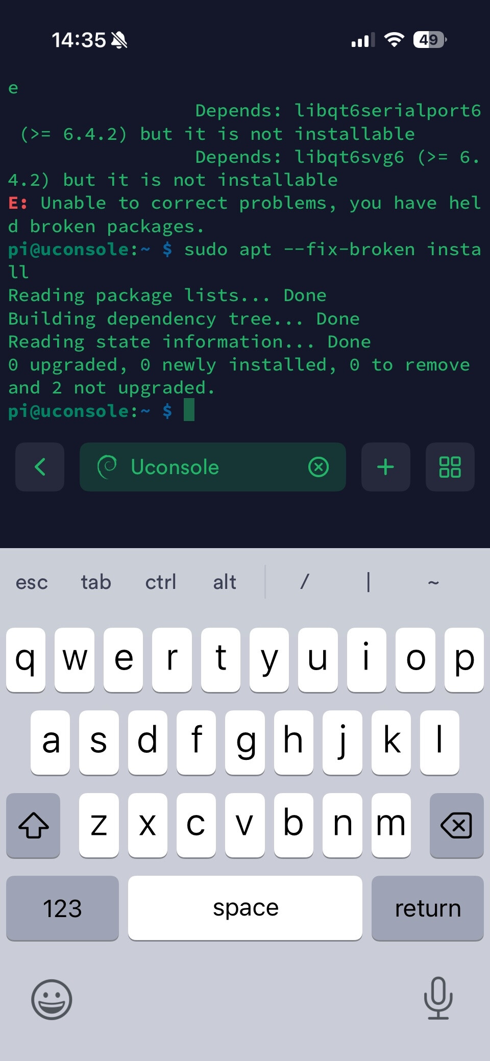

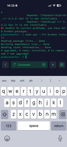

try sudo apt --fix-broken install

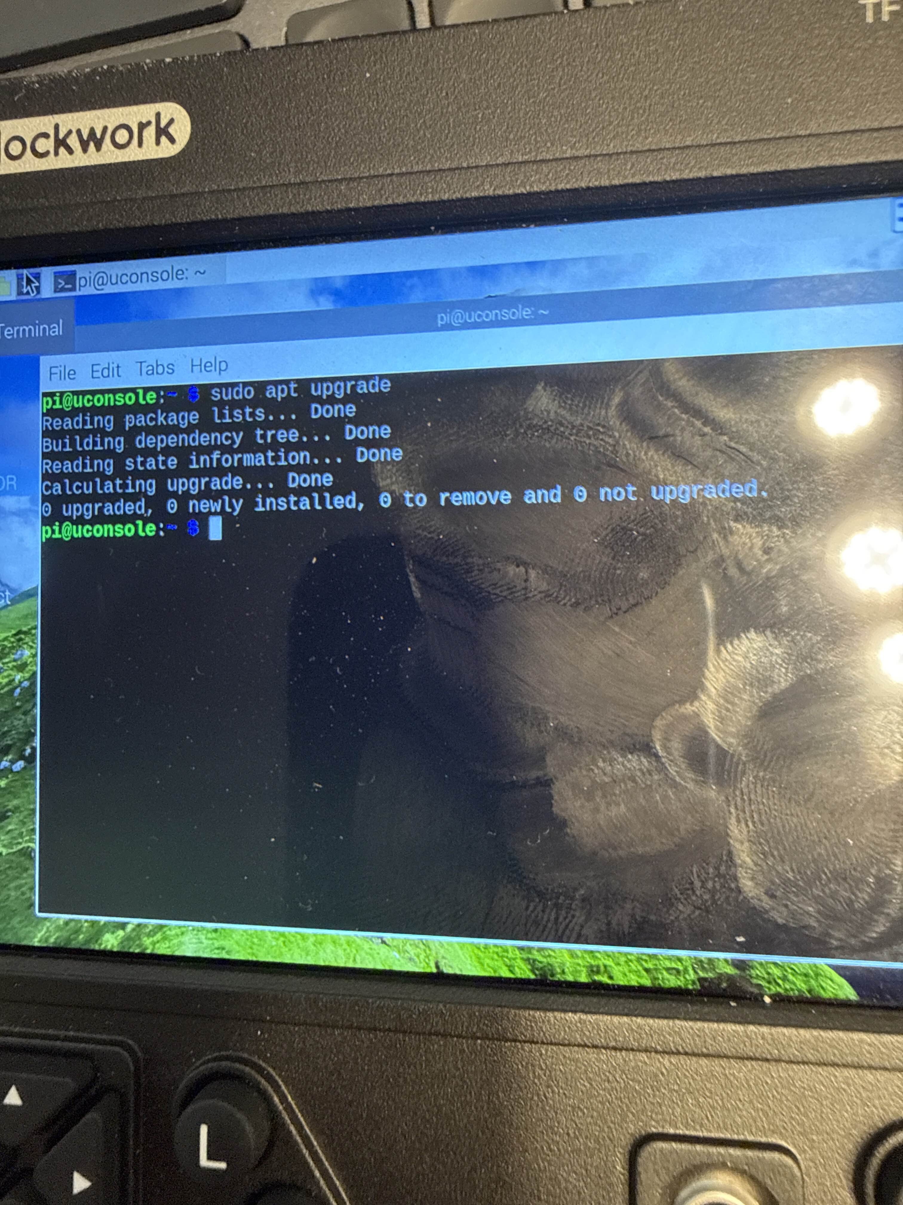

do sudo apt upgrade
is it installed now or did it remove itself

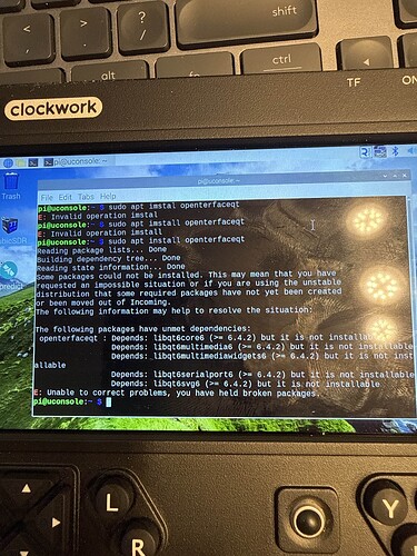

can you try installing it again
sudo apt install openterfaceqt

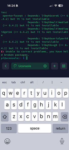

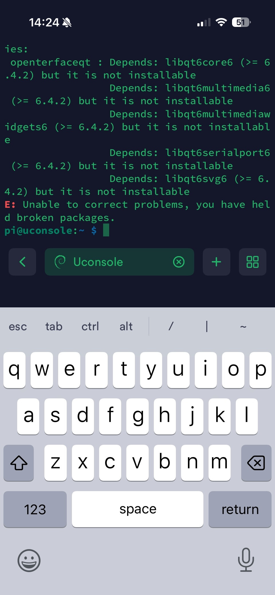

Broken packages
